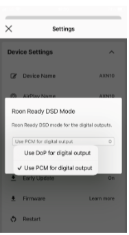

1. Navigate to the device settings of your AXN/MXN within the StreamMagic app
2. Select ’Roon Ready DSD Mode’
  • Then select ‘Use PCM for digital output’
Note: This step is required as Roon’s DSP volume control does not support Native DSD
playback.
